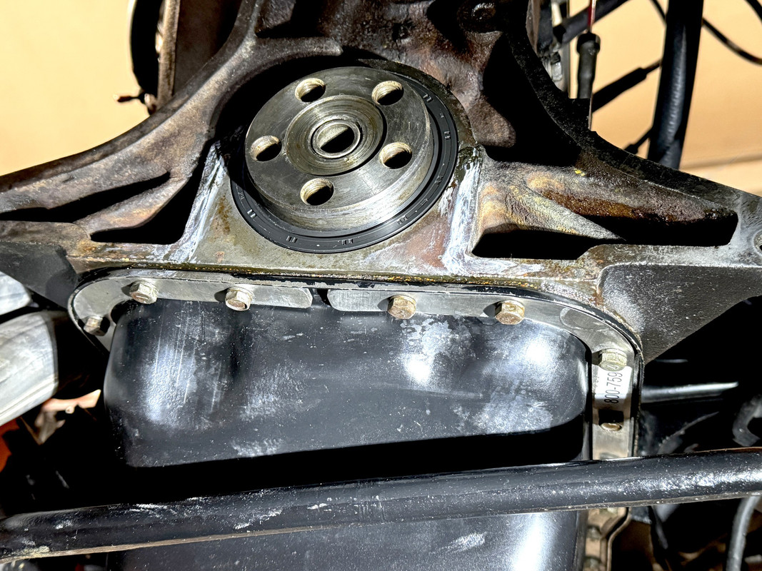

I was able to get the seal out fairly easily, thank god. The seal spring was out of place, just hanging around the crank. I don't know if I knocked it out with the screws I used to remove the seal or if it was just out of whack to begin with. I cleaned up the crank and the block/cap with a little lacquer thinner and made sure there are no burrs or anything to damage the seal so I think I'm ready to slither back under there & install the new seal. I'll put a little grease on the inner surface & try to get the seal on squarely and flush to the cap/block. There don't seem to be any grooves on the crank. Fingers crossed!
Here are a few pics from today:
Before cleaning
After cleaning

Image They are L shaped and Nissan only put them on one corner at the back. I had an extra. You have to trim one as they overlap.
If there are a lot of miles on the pilot bushing and the release bearing, now's the time to replace them.

Ah! Ok. I actually bought a set of those but I didn't know what they were called. Pilot & release are new, thankfully.
Progress report: Seal, flywheel, clutch, slave, and tranny are all back in, and oil pan L dealies are installed. I just need to put the driveshaft back in, and fill the transmission & I'll be finished! Yay! I rewarded myself with a new patch I made for my shop romper! I think I've earned it. 😁
