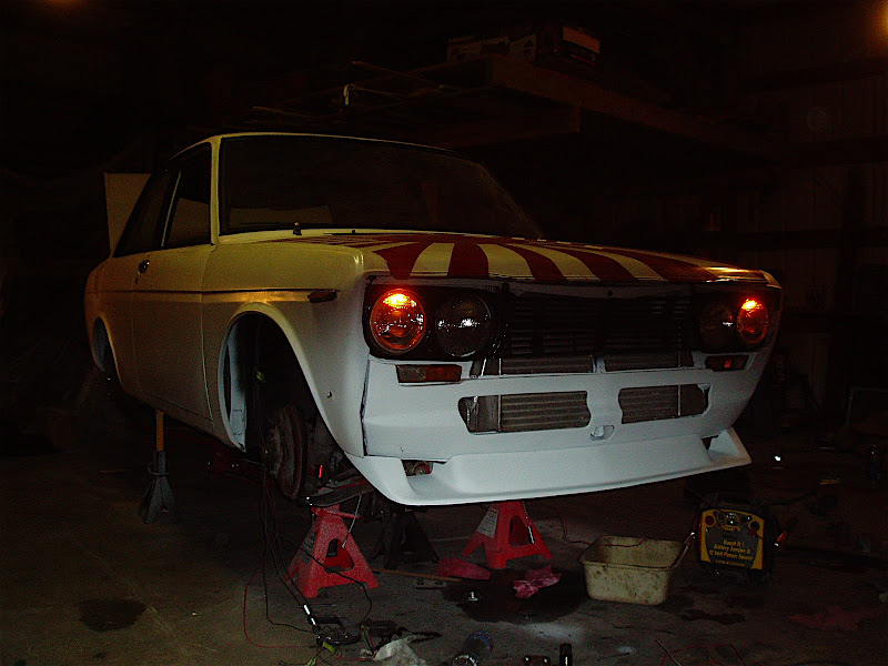

I did it :D It requires cutting the shit out of the headlight buckets and bashing in the inner fender wells.

icehouse wrote:Image
Did you use this same kit from eBay?
I have a set of the low beam ellipsiods from a 5 series and I started to cut up the headlight buckets and carriers today. I have no issues with the install, I am confident that I can do it.

My buddy ran the fancy real ones and he had to do all the same stuff.
As for quality... This actually gets into my personal life if you can believe that.... For some reason every 510 I've had in the last 5 years I been unlucky and had something smash out the headlight on the drivers side. A mud flap twice and big rocks a few times haha :D Once was on the way to Shasta, Lucky for me James sold me a new one for a dollar :D Only in my 510's too!! The BMW light faired the best out of the sealed beam units by far!!! It only has 1 crack, it's from top to bottom though, which sucks but doesn't seem to affect the light diffusion. The only thing I would do is be more careful cutting the plasic on the light, it's kinda thin and easy to go through. The lights work awesome compared to H4's 5x better!!! I wonder how nice they would be with HID's :D

Wow. What a run of bad luck with headlights. I guess I have been lucky. I have never had a 510 headlight broken. Knock on wood. :wink:
5x better then hella's. That sounds great.
I cut the plastic on the ones I have today. I used a dremel with a cut off wheel. I took my time and it was easy.
I will probably give these a try. I plan to install an NOS SSS grill I have along with NOS head light bezels so clean new headlights would look great with them.
My friend Vince just did the HID's to his Ellipsoids. I saw them lit in his shop and they are bright! I may have to do that too.

Dremal :D That's what I should have done, I used my angle grinder :D I use it for everything though :D

icehouse wrote:Dremal :D That's what I should have done, I used my angle grinder :D I use it for everything though :D
I have a 4" angle grinder. Too big for the delicate stuff. Dremel gives you good control. Even one handed. Watch the speed you set it to though. Too fast and it melts the plastic. :shock:
