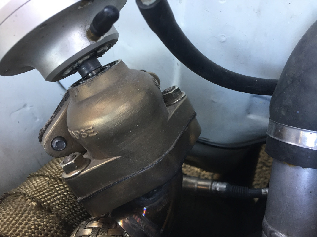

The car ran great and I was easily keeping up with Miatas in the turns and staying with higher horsepower cars on the straights. I have a lot to learn about driving, but the car did well. That is until the last session. I was not feeling the power that I had all day and took a peak at my boost gauge on the straight. I was only making 5psi at 5k RPM instead of 10+psi. After I pulled into the pit area I took a peak at all of my vacuum lines and such in case there was a leak, and then I noticed this:
I'm pretty sure it's not supposed to do that. It's disappointing that a part that is considered high quality would do that. It also seems like an odd failure in general. Thankfully it was the last session, and I was able to drive home. Overall it was a success and I can't wait for the next event.

On a side note, the waste gate just had the screws come loose. Thankfully it's an easy(ish) fix, but it will likely happen again.

What brand is that Waste gate?

bertvorgon wrote: 14 Feb 2019 07:24 What brand is that Waste gate?
It's a Synapse Engineering unit. It really is a quality unit, but the use of screws and loc-tite to hold it onto a searing hot part probably isn't the best. They were quick to let me know what the issue was with the unit, but did not provide any directions on disassembly or reassembly. I'm hoping the toque specs of "good-n-tight" will work. They even sell a "rebuild" kit that has seals and oil, but I can't find any info on actually rebuilding it.

If that waste gate turns out to be a pain in the ass, The Turbonetics ones are great..ZERO issues and well designed.
That mounting looks "standard".
http://www.turboneticsinc.com/performan ... -wastegate
You can see the "heat sink" for the valve stem and the diaphragm body is well up and away from the heat and the body it self goes up high, so the screws that hold the lid and diaphragm in place are isolated from heat. I have never lost a diaphragm and only wear them out after years and years of use.
