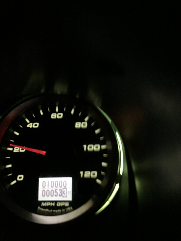

Small update, but big accomplishment (for me at least)
