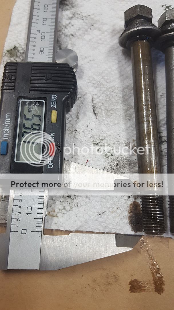

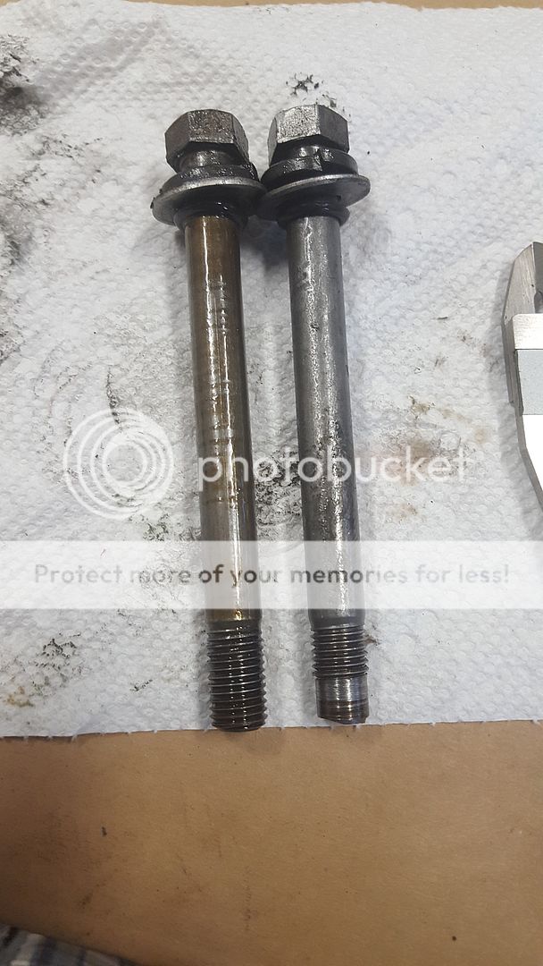

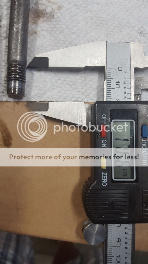

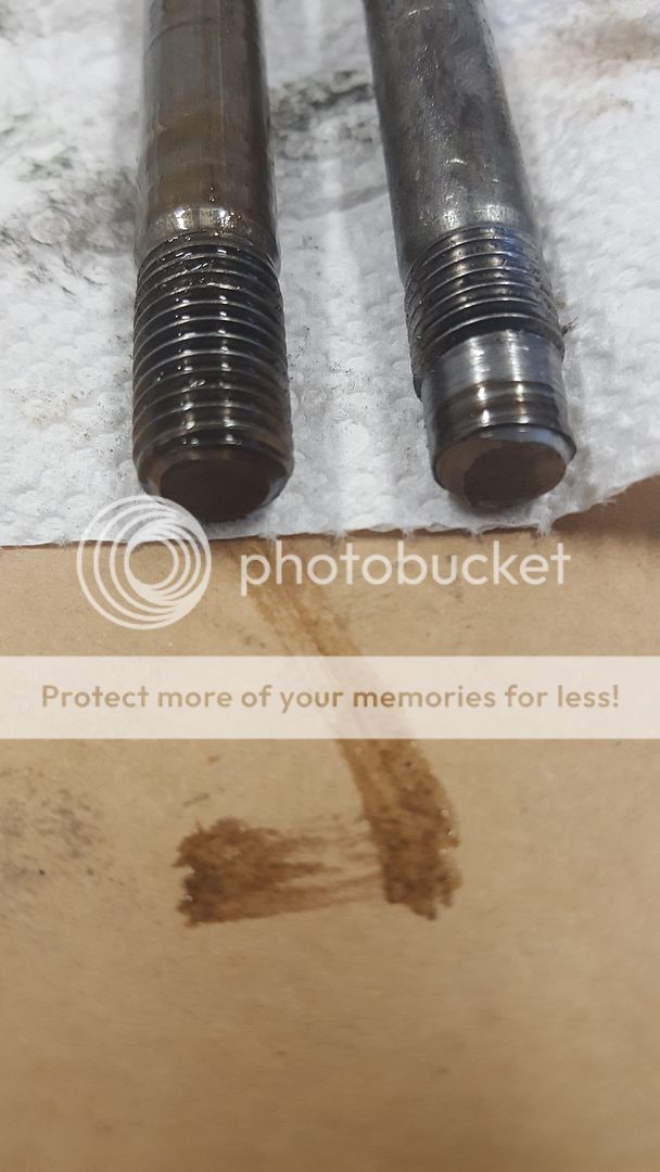

Well the diff is out. Comparing the 2 bolts there is about 1.5mm missing from one. It has about 8mm of thread left on it. You can see there was some type of impact that sheared of the end of it.

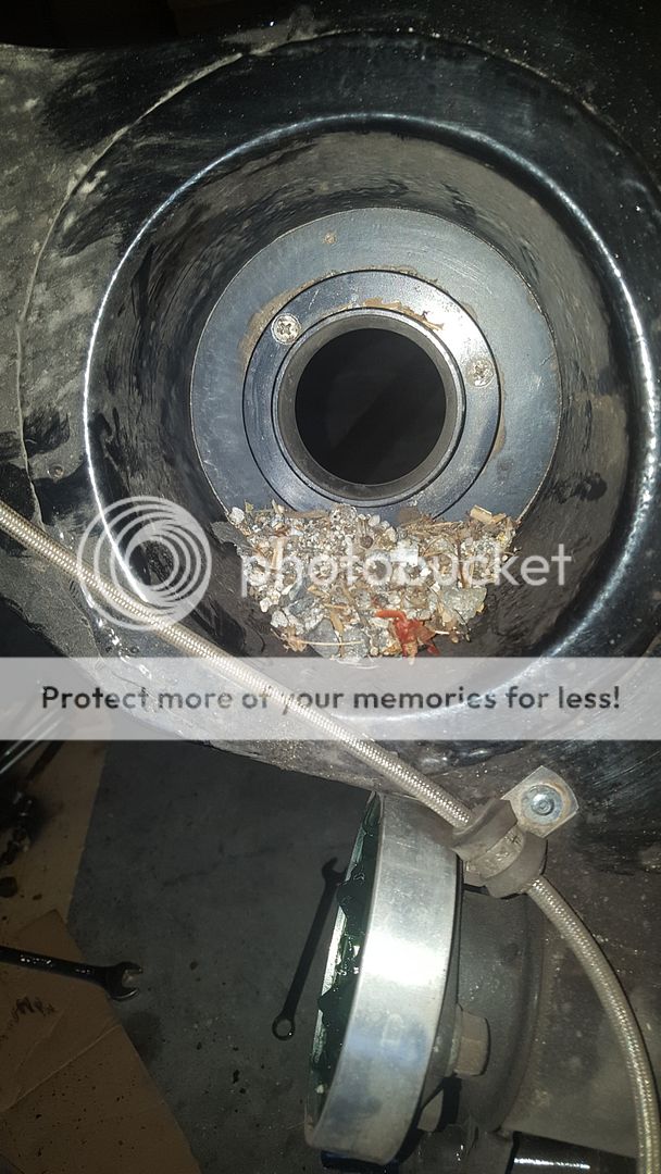

On a lighter note I found a new place that rocks collect in my car. The spring bucket on the lower control arm. They have been getting crushed in between the last loop of the spring. I will have to add that to the list of places to vacuum out after a drive.

Wow!! your lucky that bolt didn't back out into the CV. It looks to me like the bolt got cross thredded into the button which may have not been installed squarely into the side gear which tells me your thredded button may also be toast.

Well the diff is back and in its place again. There is no damage to the diff itself the threads and the last 1mm of the bolt were just where they should have been. Apparently just the force I applied with my 1/8" drive wrench was what broke it off. It must have been just barely holding on. The axle stubs feel nice and tight now. It is slightly quieter now also. The tech said everything in there looks great. I brought it home thinking I would be able to get the Redding Shockproof gear oil up here and there is none to be found on the coast at all. I ended up putting in the Royal Purple 75w140. I will see how it feels with that in and maybe just change it out if I don't like it. I took her for a short drive and all seems good so far. That is except for the clunky CV's

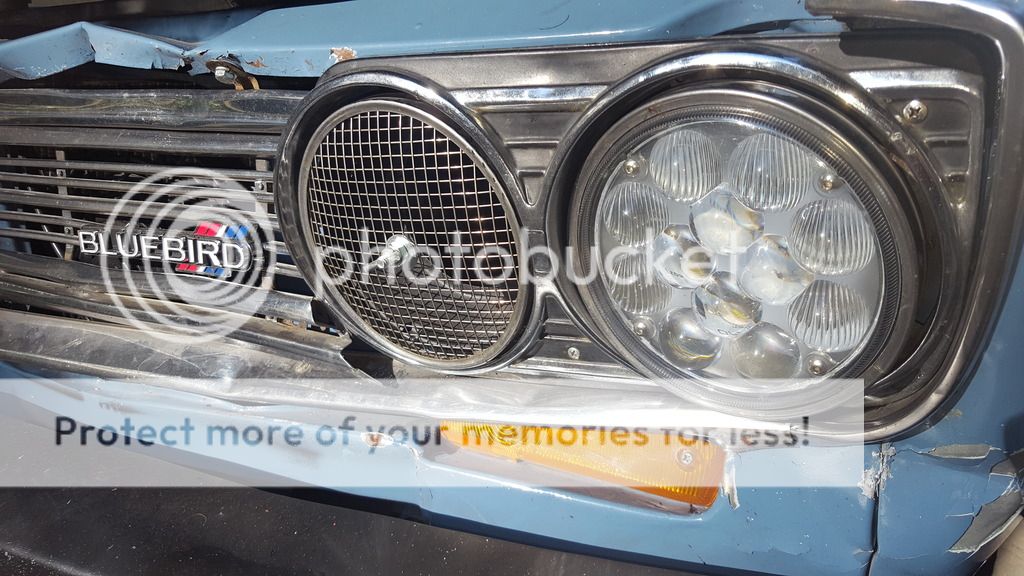

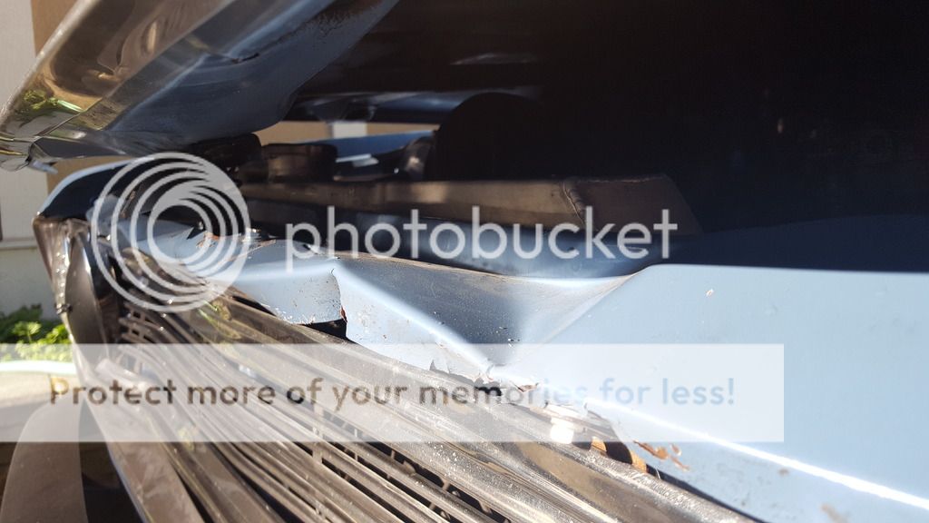

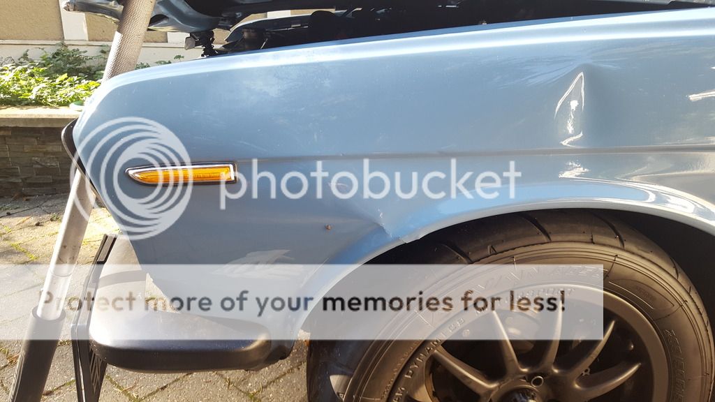

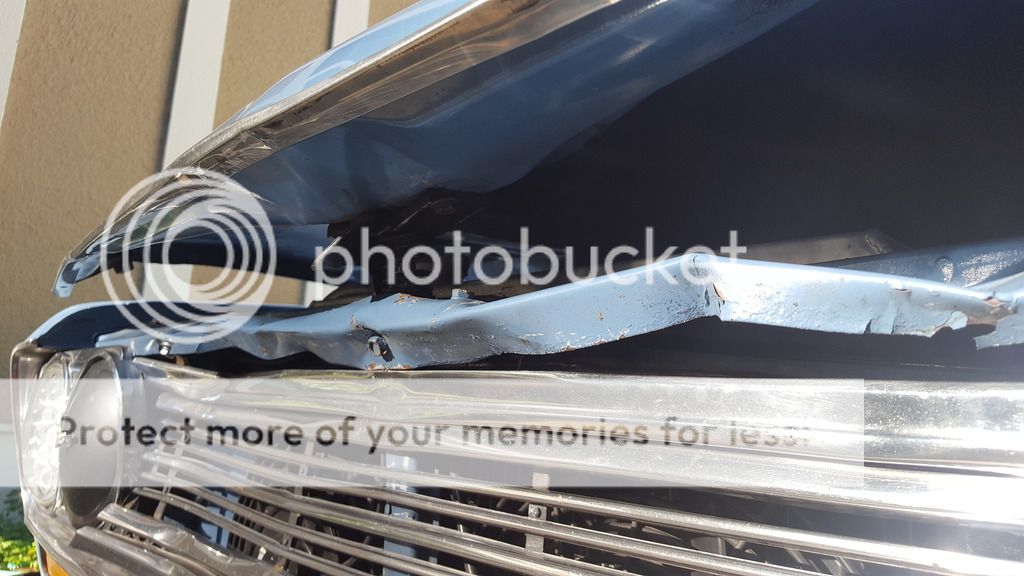

Well as some of you already know my car was hit yesterday. I was waiting to go through the booths in the ferry lineup and the guy in front of me backed into my car.

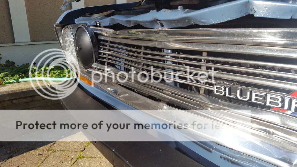

The guy admitted it was his fault and ICBC has said they will pay to have the damage repaired. It could have been worse. I was backing up to get away from him and my car popped out of gear. I was on the horn the whole time and the guy didn't even tough his brakes till after he hit me. I think about how it would have been if I had not backed up and am happy I was moving backwards when he hit me. The hood, rad support, valence , rad, fans and drivers fender are damaged. I have already spoke to Tyson at Big Time Motors and he is going to do the repairs for me.
Surprisingly the headlights and headlight trim made it without damage and the hood trim has only the smallest dent.
I have to say I have not felt that sad about something in a very long time. It was very upsetting to think that someone who just wasn't paying attention could do this much damage to something I care this much about. As angry and upset as I was I did not yell at him, curse at him or hit him like I so wanted to. I just asked him what he would have done if it had been a person walking behind him? I can only hope he is more careful in the future.

Re: 2.3L of fun
Post by GREG510 » 28 Sep 2016 16:37
Well that sure does suck. like you said could of been worse.

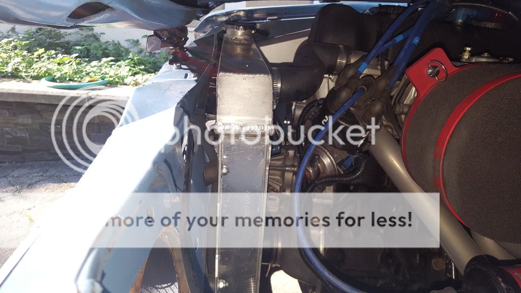

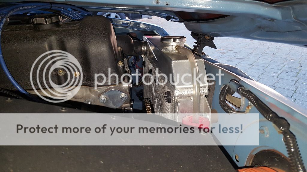

Still looks nasty though. from the one picture ,looks like the water pump hit the rad pretty good

Post by funwithmonkeys » 28 Sep 2016 16:42
It did. You can clearly see the imprint of the pully in the rad...even the bolts. At least the rad is soft so hopefully it dissipated the energy instead of the motor.
